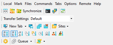

Both interfaces have several toolbars for easier access to common features.
Customizing Toolbars
Some of the toolbars are initially hidden. To show them (or hide the visible ones) go to View > Toolbars in Explorer-like interface or Options > Toolbars in Norton Commander interface. You can also use context menu of the toolbars. Note that you cannot hide toolbar with the main menu.
If you do not like order of the toolbars rearrange them using drag&drop. You can even drag them to other edge of the window or make them float outside.
For example see some of the toolbars of the Norton Commander interface.

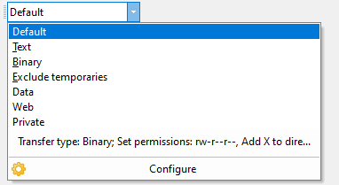

Transfer Settings presets
On Transfer Settings toolbar you can override default transfer settings by selecting one of the configured presets. Note that the first option Default represents default transfer settings
