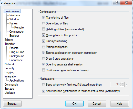

That screenshot is for Login dialog, not for Preferences dialog. In the latest beta the option is available in Advanced session setting dialog.
