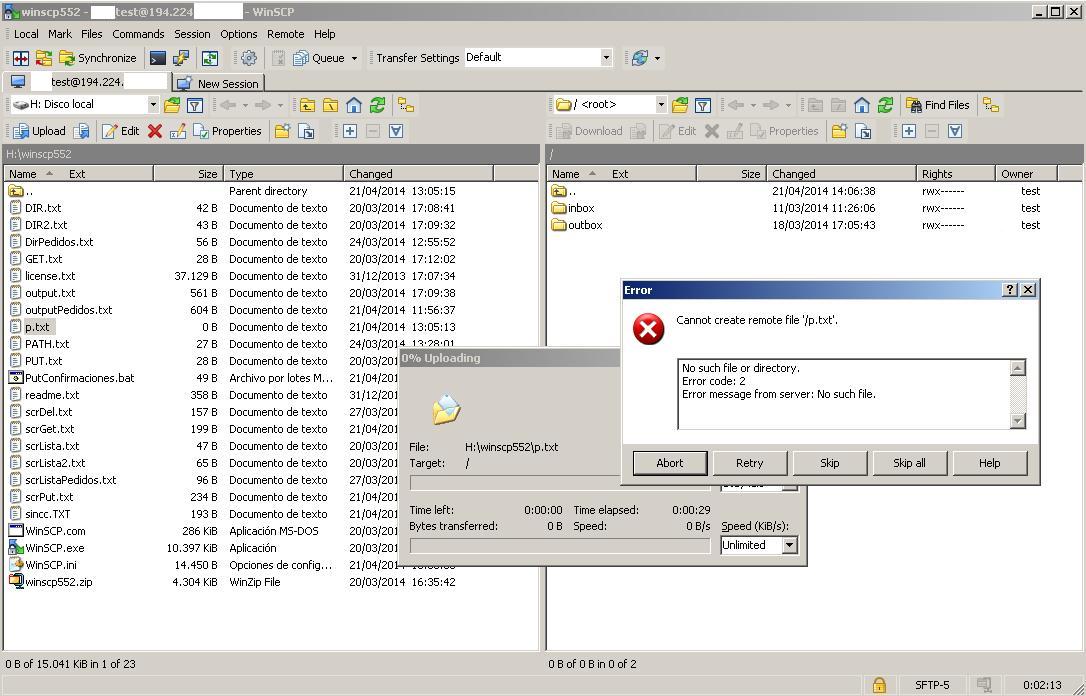

I was not able to upload any file using WinSCP GUI (see attached), but I was able to upload any file using another GUI (like CoreFTP).

Oh! The message "Error code 2 no such file" which is true but because I'm uploading, gave me a reason to prove one thing: if the file exists in the destination, it works the upload! However, this is just a patch, because it is normal that the file upload is not there, of course.
