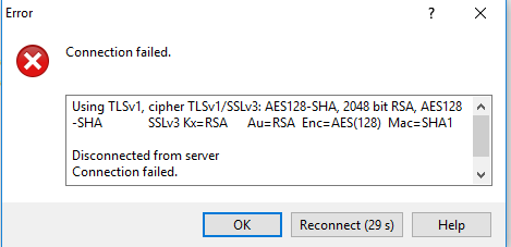

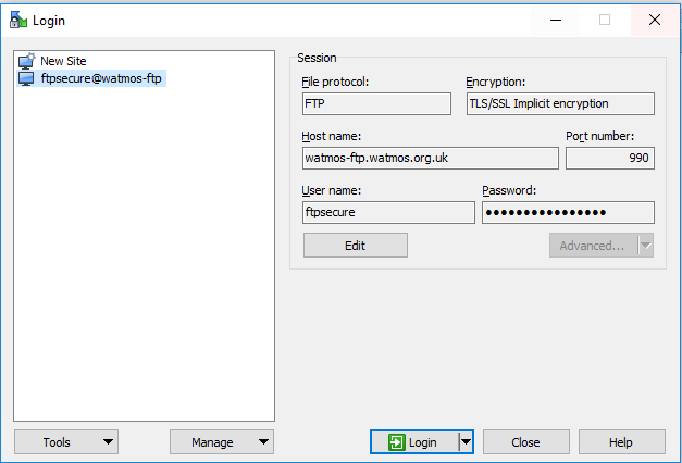

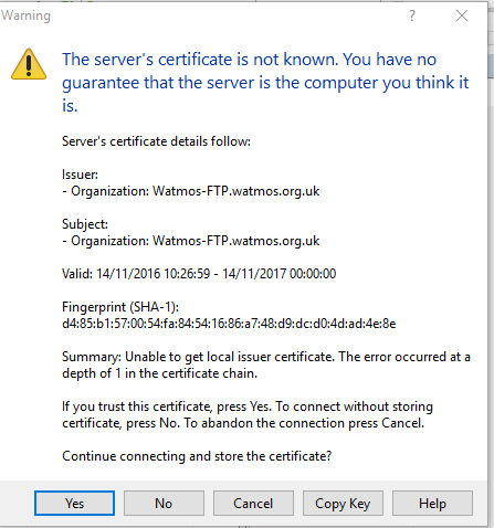

WinSCP Will not connect to my FTP site. My config is displayed in Appendix 1 then when I press login I get the screen in Appendix 2. I then click yes and get the screen as in Appendix 3.
I am using a self signed certificate to which I updated and cannot connect on.

Please attach a full session log file showing the problem (using the latest version of WinSCP). And ideally also a server-side log.
