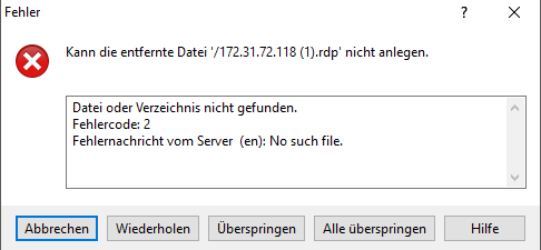

if I want to upload a file that is smaller than 100 KB to an SFTP server, I get the following error message. (see attached file)
Larger files are working fine.

Unfortunately, nothing is written to the logfile if I want to upload a file that is smaller than 101 KB. I have already increased the debug level to 2.

It's not possible. Please post the log anyway along with a matching error message.

Most likely it is because the setting "Enable transfer resume/transfer to temporary filename" is set to "Files above: 100KB". In this interface set this to "All files"
In scripts use:
put -resumesupport=on * ........
Re: Files <100kB are not transferred
@FrankIJskes: OK, but that would not explain why it works in FileZilla, as that behavior is actually different to what FileZilla does.
