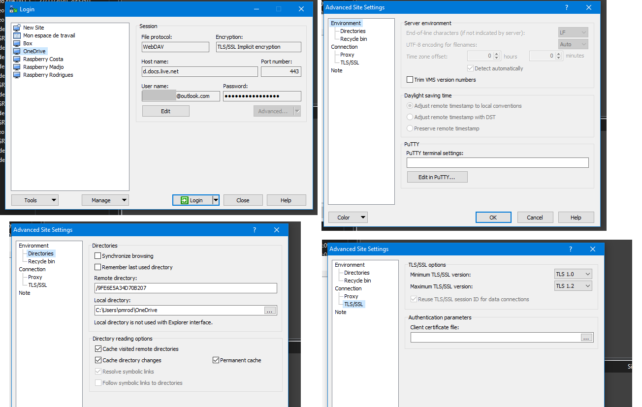

I used <invalid hyperlink removed by admin> post and I don't succeed in connecting, getting error:
Could not authenticate to server: Missing Authentication-Info header
La connexion a échouée.
Any tip please?
Thanks. O.

Trying to log but I don't succeed.
I don't see the option in WinSCP.
Then tried in command line like:
davs://prefix%40suffix@d.docs.live.net/path/ /log="C:\Temp\winscp.log" /loglevel=0
But no log is generated...
and still get the error message I put in attachment.
Cheers.
O.

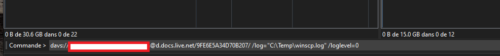

That's what I did:
not working...

Where did you do that? Show us a complete code/script/commandline, whatever you are doing.
I did it in in WinSCP command line...

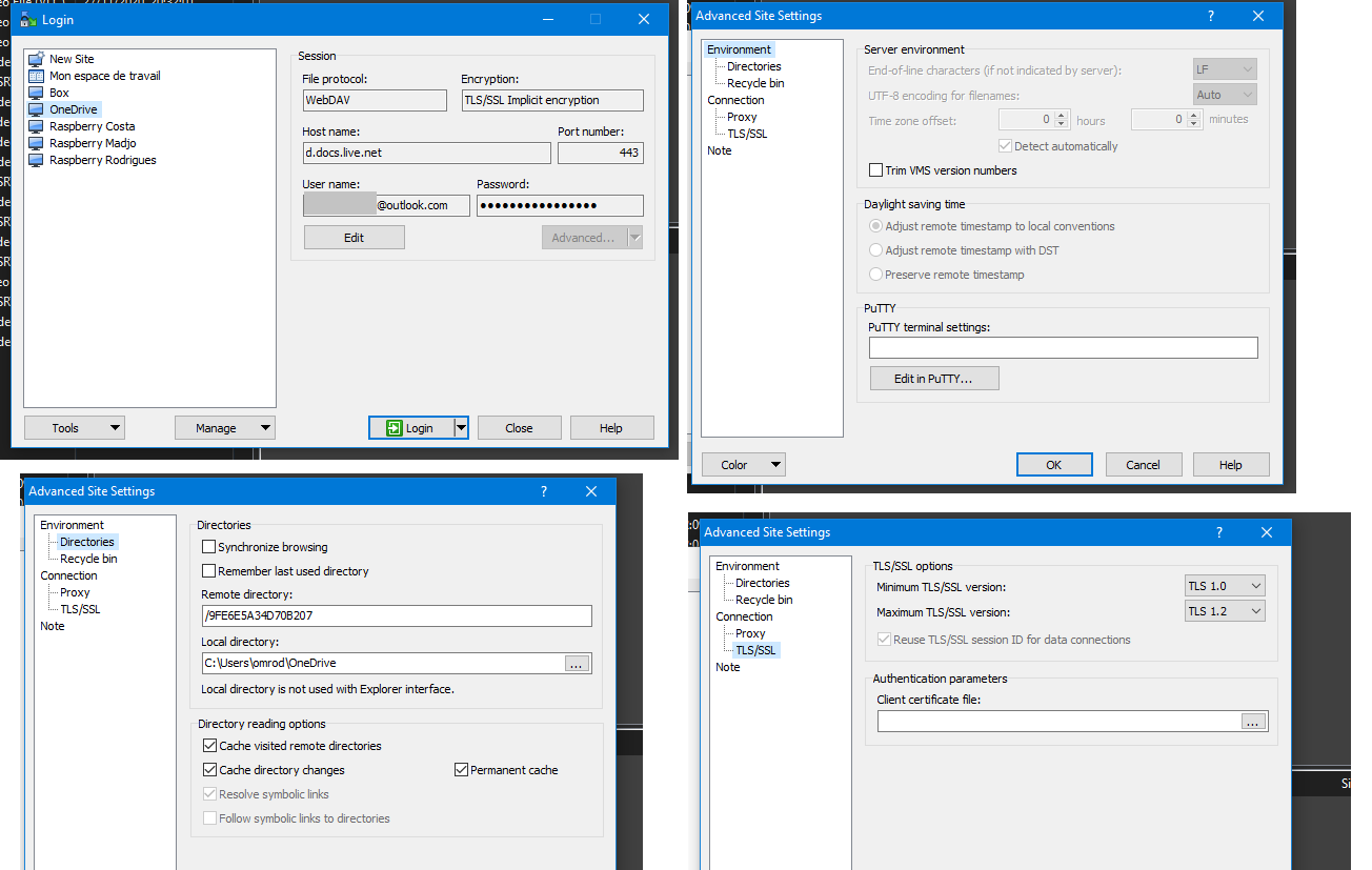

Sorry, I do not know how to help you, only to suggest that you tripple check your credentials and your "customer id". If I follow the instructions in the documentation, I can login to my personal OneDrive account without any problem.

OK nevermind.
It happens when double check is activated.
At first I tried the app password (https://account.live.com/proofs/manage/additional#AppPassword) but it was not working. I tried with another OneDrive account, and the app password worked.
Then I tried again with first account, and tada!!! working.
Then it is as the Failure accessing OneDrive, you have to use app password if you have double check activated on your Microsoft account...
