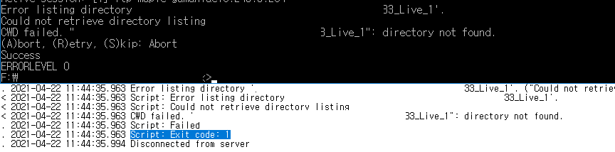

Hello
I have a problem.
I'm using the below script.
"F:\Tools\WinSCP_51710\WinSCP.com" ^
  /log="F:\Tools\WinSCP_51710\WinSCP_51710.log" /ini=nul ^
  /command ^
    "option batch abort" ^
    "open ftp://%ftp_username%:%ftp_password%@%FTP_IP% -explicit -certificate=*" ^
    "ls "%FTP_DIR_LIVE%"" ^
    "exit"
if %WINSCP_RESULT% equ 0 (
  echo Success
) else (
  echo Error
ECHO ERRORLEVEL %ERRORLEVEL%
But %WINSCP_RESULT% is always 0 even if the log remains "Script: Exit code: 1".
I want to get the real error code.
Please advise.
Thank you.

Your script looks good. There's probably some tiny syntax problem that you post does not show.
Check this: https://winscp.net/eng/docs/faq_batch_file#newline_escaping
What do you get if you put ECHO ERRORLEVEL %ERRORLEVEL% right after the "exit" line?
This is wrong: "ls "%FTP_DIR_LIVE%"" it should be:
    "ls ""%FTP_DIR_LIVE%""" ^
What do you get if you try this?
winscp.com /command "foo"
echo %ERRORLEVEL%
