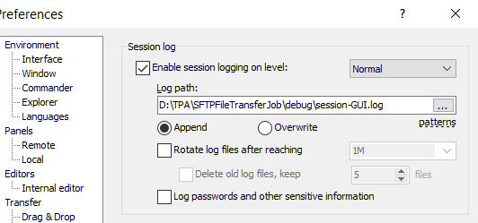

Anyways, I have attached session log from GUI with normal level.
And attached debug and session log, after removing session.DebugLogLevel = 1;
Please check 3 files I have attached.
