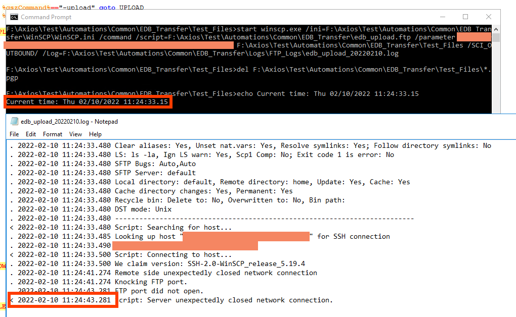

I have an issue with a batch program. When I call WinSCP to run a command script file, the batch file does not wait for WinSCP to complete it's tasks prior to going to the next command.
Here is how I'm calling WinSCP and running the FTP script:
start winscp.exe /ini=F:\Axios\Test\Automations\Common\EDB_Transfer\WinSCP\WinSCP.ini /command script=F:\Axios\Test\Automations\Common\EDB_Transfer\edb_upload.ftp /parameter ftp.server.my myusername password localfolder destinationftpfolder /Log=F:\Axios\Test\Automations\Common\EDB_Transfer\Logs\FTP_Logs\edb_upload_20220210.log

If you look at the attached image, you can see that the start WinSCP command finished at 11:24.33.15, however, my FTP script was still running and received a connection error at 11:24:43.281.
Am I missing something?
Thank you, and I appreciate the help.

The very purpose of the Windows start command is to start something in a different window and do not wait for it.
If you want to wait, remove the start command.
And in batch file you should use winscp.com instead of winscp.exe.
https://winscp.net/eng/docs/executables
