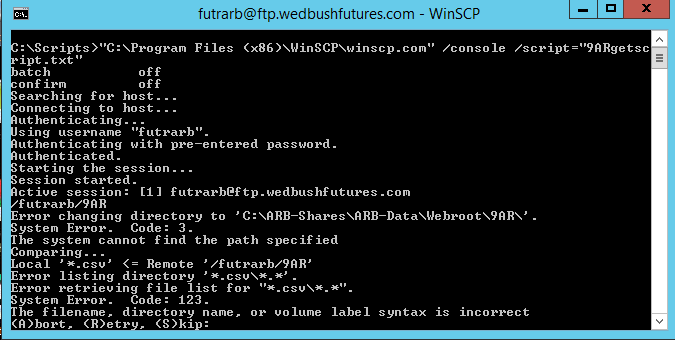

Hi all, I have been working on this script to try to get new files or changed files from an email directory and upload them to a database server. I have been trying to do this with both scripting and PowerShell code but I haven't been successful yet. Here is what I have for the script:

This is the error it gives me:

Re: Scripting FTP for new/modified files to go from remote server to local server.
The synchronize command takes directory path only, so no *:
synchronize local -filemask="*>=1D" c:\hares\Data\W\9AR
