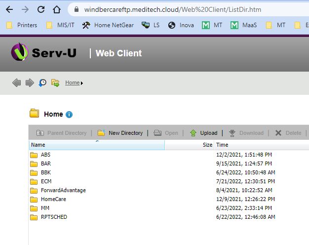

I am accessing a vendor's SFTP site. The provide a GUI in which I can see all of the folders. My goal is to use scripting to download and upload files instead of doing it manually via their GUI. When I log into their site using SCP GUI, I can see some of the folders, but not all. I have tried with both the Commander and Explorer interfaces. (This has never worked for me.) Same when I script. I asked the vendor and they don't think it is on their side. They said all folders are set up the same. What could I look at or ask them to look at? More details below:

I'm uploading a session log. I'm also uploading Capture.jpg. This shows a screenshot of the folders I can see when I access the SFTP server via a browser. When I use SCP I can't see the MM folder or the RPTSCHED folder. I also tried FileZilla and it behaves the same as SCP. But the vendor assures me the folders are all set up the same. Thanks for your input.
Description: Screen shot of folders available via browser.
Description: Session log of attempt to access MM folder.

I was asking for "session log of the GUI session that fails to display some [MM] folder". Though if FileZilla does not display the folder either, then it's most likely a problem on the server-side anyway. That some web-interface displays the folder is not really relevant.

< 2022-09-01 14:29:54.640 Type: SSH_FXP_NAME, Size: 538, Number: 2828
< 2022-09-01 14:29:54.640 68,00,00,0B,0C,00,00,00,06,00,00,00,03,41,42,53,00,00,03,BD,02,00,00,00,00,
The highlighted part of the response from the server shows that it returned 6 entries. And 6 entries did WinSCP decode from the response:
. 2022-09-01 14:29:54.640 ABS;D;0;2021-12-02T18:51:48.000Z;4;"user" [0];"group" [0];rwxrwxrwx;1
. 2022-09-01 14:29:54.640 BAR;D;0;2021-09-15T17:24:57.000Z;4;"user" [0];"group" [0];rwxrwxrwx;1
. 2022-09-01 14:29:54.640 BBK;D;0;2022-06-24T14:50:48.000Z;4;"user" [0];"group" [0];rwxrwxrwx;1
. 2022-09-01 14:29:54.640 ECM;D;0;2022-07-21T16:30:51.000Z;4;"user" [0];"group" [0];rwxrwxrwx;1
. 2022-09-01 14:29:54.640 ForwardAdvantage;D;0;2021-08-04T14:22:52.000Z;4;"user" [0];"group" [0];rwxrwxrwx;1
. 2022-09-01 14:29:54.640 HomeCare;D;0;2021-12-09T17:26:22.000Z;4;"user" [0];"group" [0];rwxrwxrwx;1
And that's it. There's nothing more. No MM. The server does not return it.
