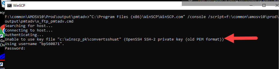

danp306
CT
Getting closer...
Hi Martin,
Thanks so much for your help. I'll gladly donate $$ for your help.
I did get to at least get logged into the site, but it's not recognizing the public key.
Please see the attached screenshot. Any ideas?
Thanks again
Dan
