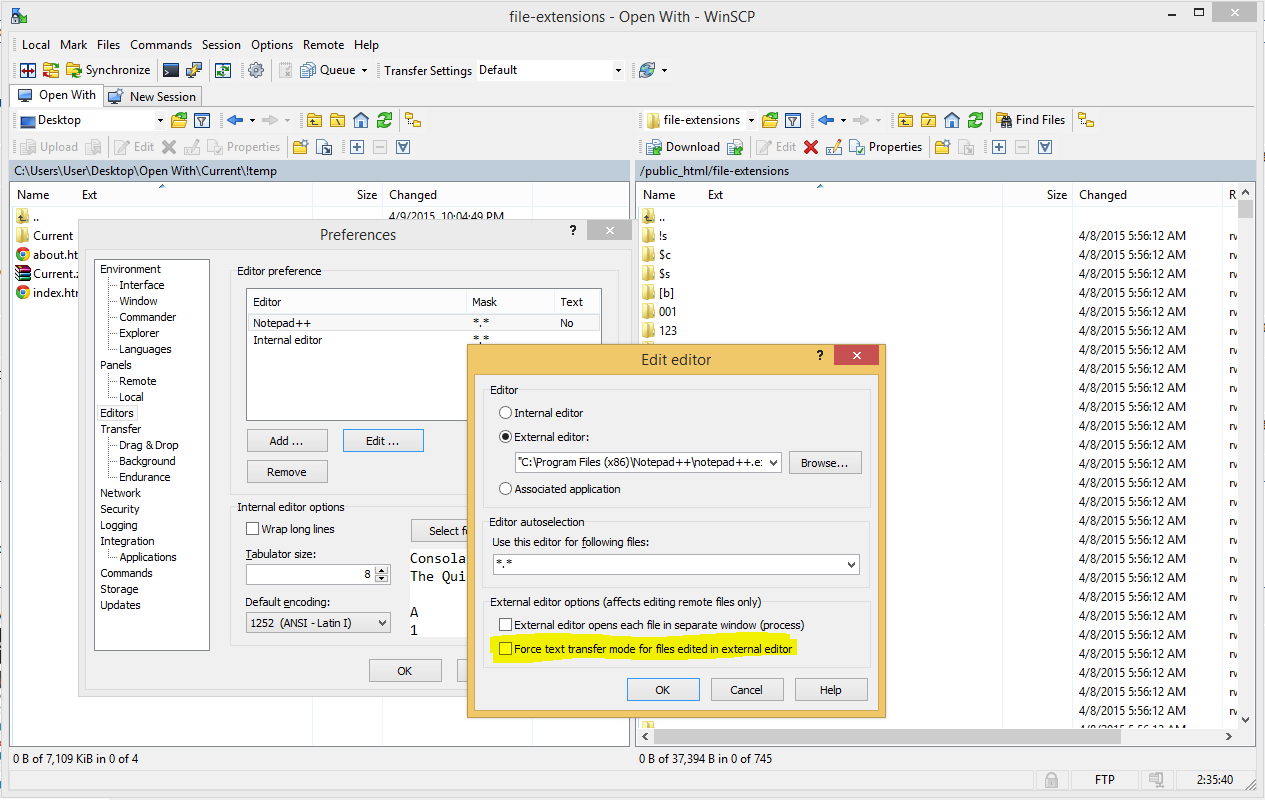

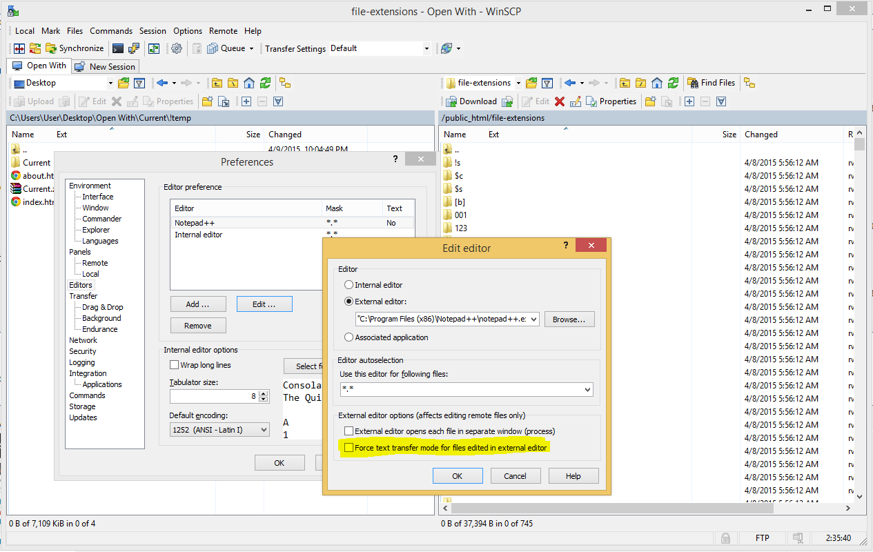

This issue baffled me too for a while, and I even filed a support ticket with my host. The fix was pretty easy, all you need to do is uncheck the box on the attached screenshot.
Martin, you might want to disable this setting by default for external editors in future versions.
