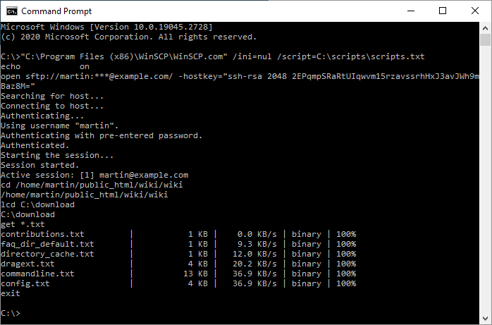

In addition to graphical interface, WinSCP offers scripting/console interface with many commands. The commands can be typed in interactively, or read from script file or another source.
Using Scripting
See command-line parameters to learn how to enter the console/scripting mode.
For automation, commands can be read from a script file specified by /script switch, from standard input or passed from the command-line using the /command switch.
