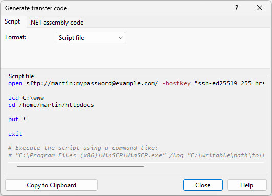

Script Tab
Use the Script tab to generate a WinSCP script template for the session or the file transfer.
The script will include:
- the
opencommand with the session URL and all other switches needed to configure the session. - (When generating a code for a session) a placeholder text to be replaced with commands.
- (When generating a code for a file transfer) the
cdandlcdcommands to navigate to the source and destination folders of the transfer and theputorgetcommands to actually transfer the files (with all needed switches to setup any non-default transfer settings).- If you had all files selected in the source panel, a code to upload all files from the source directory will be generated.
- If you had only some files selected in the source panel, a code to upload only the selected files (but three at most) will be generated. If file names contain any file mask special characters, they will be escaped.
- the
exitcommand to end the script.
Use the Format to select a format of the script to generate:
- Script file – Generates a script file template that you execute using the
/scriptcommand-line switch. - Batch file – Generates a Windows batch file (
.bat) template that executes thewinscp.comwith the above commands, specified using the/commandcommand-line switch. Additionally the batch file enables session logging using the/logswitch and isolates the script run from a GUI configuration using the/ini=nulswitch. At the end, the batch file checks WinSCP exit code to choose further actions to take; and propagates the WinSCP exit code to a batch file exit code using theexit /bcommand. Make sure you keep the exact format of the multi-linewinscp.comcommand, as multi-line batch file commands are fragile. - Command-line – Generates a command-line for the
winscp.exe(but usable forwinscp.comtoo) with the above commands, session logging and configuration isolation (see the previous point). The command-line is suitable for task managers of all kinds, like Windows Scheduler or SSIS. Depending on your requirements, you may want prepend the/consoleswitch to make the script console visible, while the script is running. - PowerShell script – Generates a PowerShell script file (
.ps1) template that executes thewinscp.comwith the above commands, specified using the/commandcommand-line switch. Additionally the script file enables session logging using the/logswitch and isolates the script run from a GUI configuration using the/ini=nulswitch. At the end, the script file checks WinSCP exit code to choose further actions to take; and propagates the WinSCP exit code to a script exit code using theexitkeyword. Instead of runningwinscp.com, consider using WinSCP .NET assembly in PowerShell.
In the Command-line (and possibly also in the Batch file), you should modify a path to a session log file in the /log switch.
The script will not include options to verify a host key or an untrusted certificate, if the session was not opened before yet. Open the session at least once, before generating the script.
You can click on script commands and switches and command-line switches to open their respective help pages.

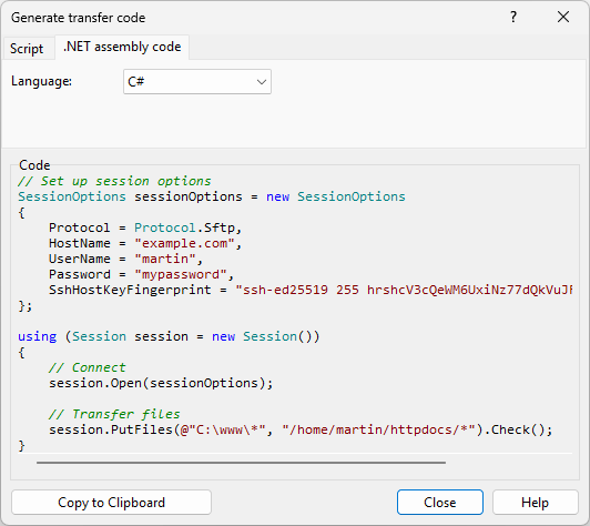

.NET Assembly Code Tab
Use the .NET assembly tab to generate a code template using WinSCP .NET assembly for the session or the file transfer.
The code will:
- Set up
SessionOptionswith all properties needed to configure the session. - Create
Sessioninstance. - Open the session using
Session.Open - (When generating a code for a session) Include a placeholder text to be replaced with calls to
Sessionmethods. - (When generating a code for a file transfer) Transfer files using
Session.PutFilesorSession.GetFiles. TheTransferOptionsclass instance will be constructed and set up, if any non-default transfer settings are used. TheOperationResultBase.Checkmethod will be called on results of the methods to throw an exception on any error.- If you had all files selected in the source panel, a code to upload all files from the source directory will be generated.
RemotePath.EscapeFileMaskmethod will be called to escape them.
- Dispose the
Sessioninstance.
Use the Language to select a language to generate the template for. Available languages are C#, VB.NET and PowerShell.
The code will not set properties to verify a host key (SessionOptions.SshHostKeyFingerprint) or an untrusted certificate (SessionOptions.TlsHostCertificateFingerprint), if the session was not opened before yet. Open the session at least once, before generating the code.
You can click on classes, methods and properties to open their respective help pages.
