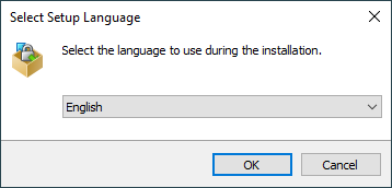

  2. Select the language you want to use (both for installation and later when using WinSCP).
