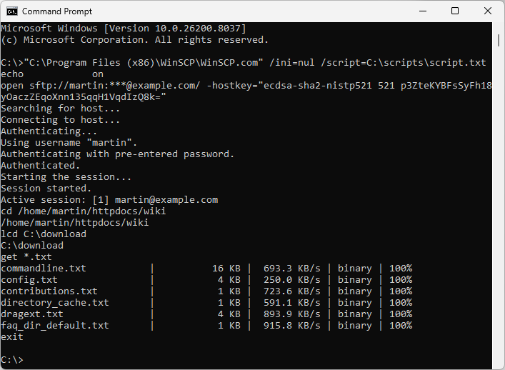

The example below connects to example.com server with account user, downloads file and closes the session. Then it connects to the same server with the account user2 and uploads the file back.
# Automatically abort script on errors option batch abort # Disable overwrite confirmations that conflict with the previous option confirm off # Connect using a password # open sftp://user:password@example.com -hostkey="ssh-rsa 1024 xx:xx:xx:xx:xx:xx:xx:xx:xx:xx:xx:xx:xx:xx:xx:xx" # Connect open sftp://user@example.com -hostkey="ssh-rsa 1024 xx:xx:xx:xx:xx:xx:xx:xx:xx:xx:xx:xx:xx:xx:xx:xx" # Change remote directory cd /home/user # Force binary mode transfer option transfer binary # Download file to the local directory d:\ get examplefile.txt d:\ # Disconnect close # Connect as a different user open user2@example.com # Change the remote directory cd /home/user2 # Upload the file to current working directory put d:\examplefile.txt # Disconnect close # Exit WinSCP exit
Save the script to the file example.txt. To execute the script file use the following command. As the script connects the session itself, using the command open, omit the session command-line parameter.
winscp.exe /console /script=example.txt
For simple scripts you can specify all the commands on command-line using /command switch:
winscp.exe /console /command "option batch abort" "open user@example.com" "get examplefile.txt d:\" "exit"
Instead of using open command you can also open a session using a command-line parameter. Note that in that case session is opened yet before script starts. Particularly option commands do not apply yet. Generally you should avoid using this method.
winscp.exe /console /script=example.txt user@example.com
