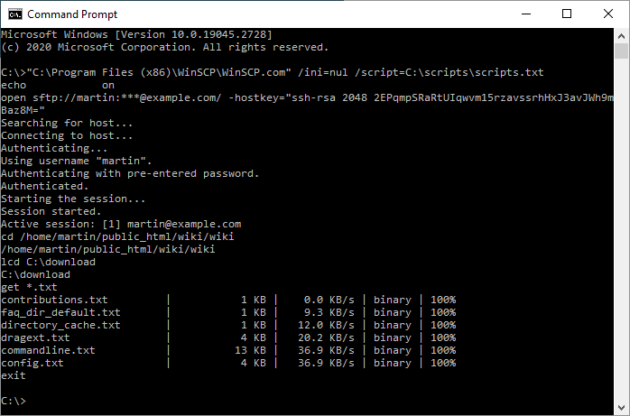

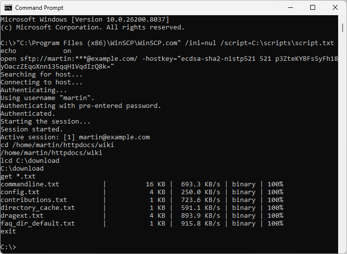

Save the script to the file example.txt. To execute the script file use the following command.
winscp.com /ini=nul /script=example.txt
