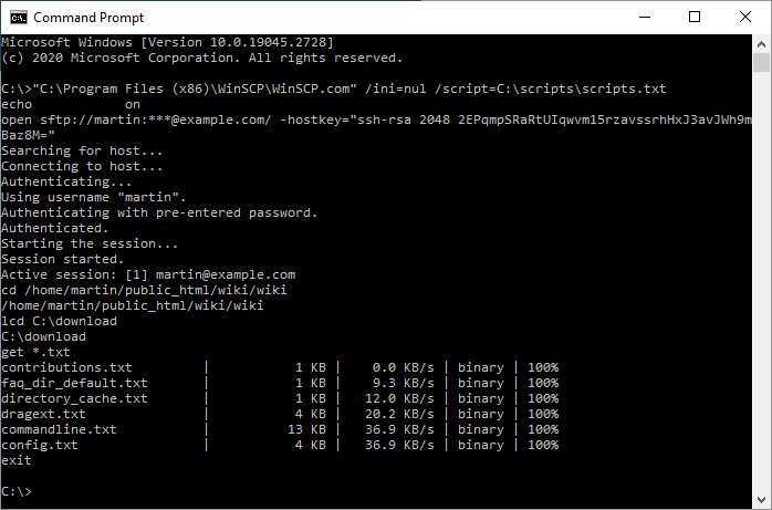

Example
In the example below, WinSCP connects to example.com server with account user, downloads file and closes the session. Then it connects to the same server with the account user2 and uploads the file back.
# Automatically abort script on errors option batch abort # Disable overwrite confirmations that conflict with the previous option confirm off # Connect open sftp://user:password@example.com/ -hostkey="ssh-rsa 2048 xx:xx:xx:xx:xx:xx:xx:xx:xx:xx:xx:xx:xx:xx:xx:xx" # Change remote directory cd /home/user # Force binary mode transfer option transfer binary # Download file to the local directory d:\ get examplefile.txt d:\ # Disconnect close # Connect as a different user open sftp://user2:password@example.com/ # Change the remote directory cd /home/user2 # Upload the file to current working directory put d:\examplefile.txt # Disconnect close # Exit WinSCP exit
Save the script to the file example.txt. To execute the script file use the following command.
winscp.com /script=example.txt
For simple scripts you can specify all the commands on command-line using /command switch:
winscp.com /command "option batch abort" "open sftp://user:password@example.com/ -hostkey=""ssh-rsa 2048 xx:xx:xx:xx:xx:xx:xx:xx:xx:xx:xx:xx:xx:xx:xx:xx""" "get examplefile.txt d:\" "exit"
