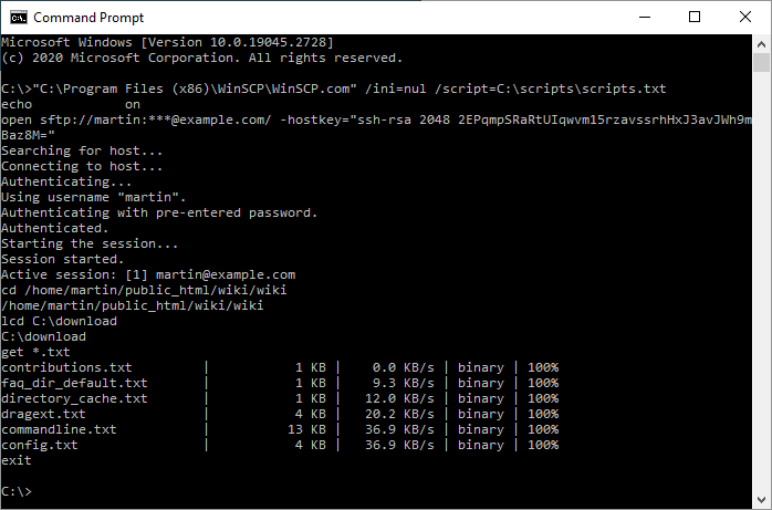

Save the script to the file example.txt. To execute the script file use the following command.
winscp.com /script=example.txt
